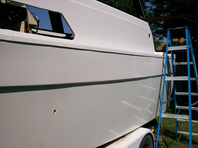

Check out my paint job:
http://forums.iboats.com/showthread.php?t=237400&highlight=1978+Reinell
