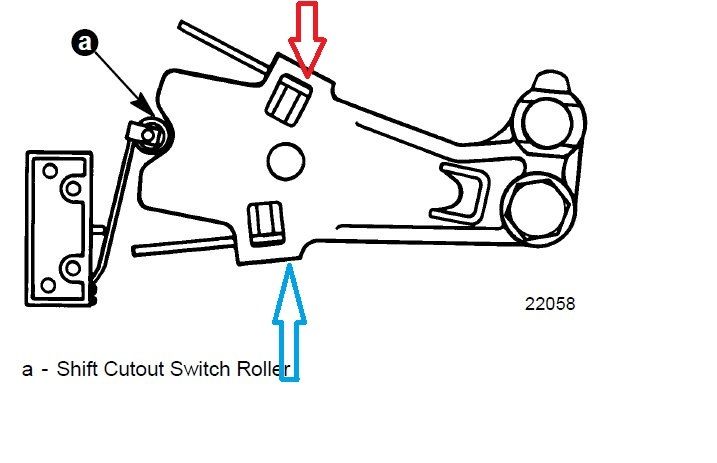

Remove the cable and barrel,Push red down and blue up. the plate must spring back so the roller is in the notch
andrewterri
Jun 25, 2014
437
If I push on the side with the blue arrow it does not spring back. It does not take much to get it back into the valley but it will not do it on its own.

no matter what, that arm must move freely and spring back to that the wheel sets in the valley.
andrewterri
Jun 25, 2014
437
I loosened the bolt that holds it down to the valve cover and it works perfect now. It was too tight. To anyone reading this in the future try loosening that bolt and see of it works. Once again thank you guys, could not have done it without you all. Looks like the kids get there fishing trip this weekend after all :fish2:
