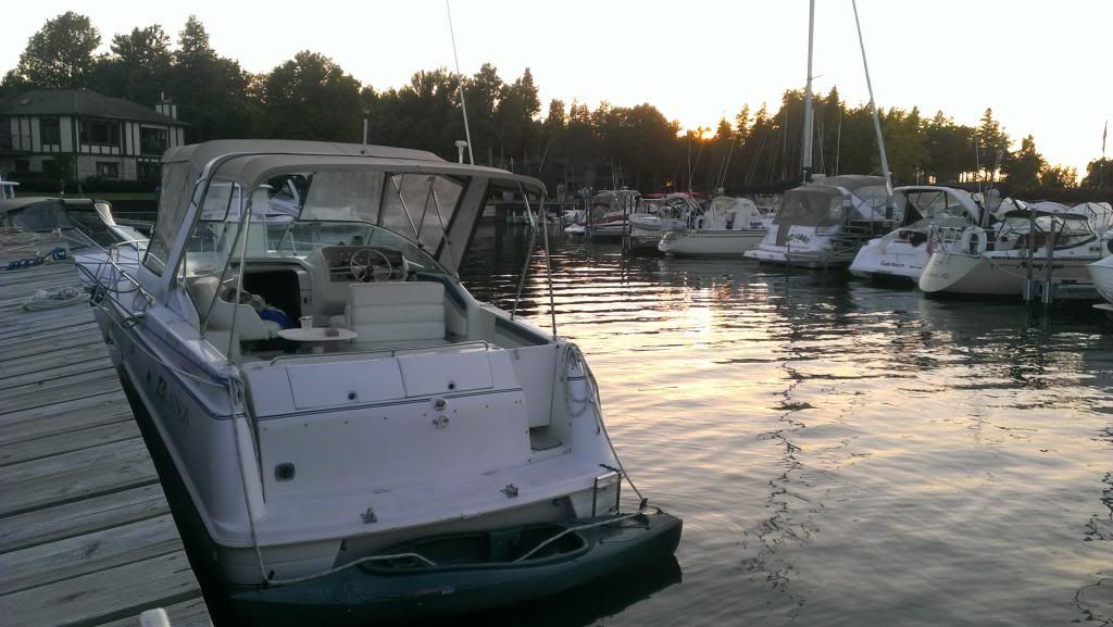

P.S. a little sample of the weekend!

Nice pictures!
