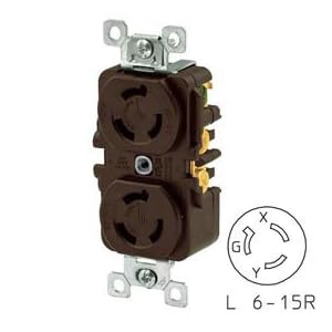

Hmmmm, I don't think they make 30A 240V receptacles that are made to "daisy chain" off of like 15/20A 240V duplex types are.
I could be wrong (I'm not a licensed electrician) but, going by the make of the hardware out there, I'd say no it's NOT ok, an addition run from the sub panel has to be made for an additional 30A 240V receptacle.
As mentioned, unless you're using 15/20A 240V duplex types.........
See 15R types (120V here) and how they're are wired off the main bus but can be duplex 15/20A and wired for 240V as per manu's 240V duplex type allow BUT, as seen the 30R and 50R types also tap the main but, manu's don't make/allow duplex in those amperes.
