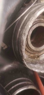

Attached is a picture showing the corrosion.

That's what I thought...looking at it, that appears to be the result of water laying in the D/S bellows and getting under the edge of it and corroding the aluminum there.
You have a couple of choices, changing that housing involves pulling the engine so that's not a great option for you I'm assuming!
I would find out if anyone welds aluminum where you are located, like a shop that fixes lower units when the skeg gets torn up. That would probably be the most lasting way to fix that.
The other thing you could do is call the company that sells Belzona, and ask if their products will work on that type of repair.

Success !! I was able to remove the pivot housing completely. Here is what I did:
1) Disconnect the shift cable at the engine and tape the barrel to keep it in place as you suggested.
2) Loosen the nut on the back of the shift cable at the pivot housing but only 1/2 a turn to avoid twisting the shift cable. Do not try to take it out completely.
3) Remove the 2 pivot screws that hold the pivot housing on the transom. This was not easy as that takes a lot of torque. I ordered a 1/2 in drive from Amazon, $8. I used a long-handled torque wrench to get the torque I needed. I pulled the pivot housing out just enough to get a wrench on the back of the shift cable. I held the shift cable from turning while I rotated the whole pivot housing around the cable till it came off.
4) With good access to the gimbal housing I can clean it up, wire brush it using a drill attachment, coat it with CLR, wire brush some more.
5) The next step will be to build back up the tube on the gimbal housing with JB Weld to create the attachment point for the U-Joint bellows.

53,303
the one issue you will come into. the JB weld will come loose in a few months as the corrosion is into the base metal and will propagate between the aluminum and epoxy
I recommend getting it welded.
This is a pay once cry once type of repair.

Looking at the extent of it, I agree with Scott, I'd get it welded, one-and-done

I had a timing chain cover that looked like that. Gave it to a certified welder and you would be very hard pressed to tell its repaired. Honestly, skip the epoxy band aid and go get it done right the first time.

How would they weld it? Are you suggesting finding a replacement end of the gimbal housing that is not corroded and have it welded in place?
If I do repair with JB Weld I would paint it with a good primer and marine paint to try to prevent corrosion from coming back.
53,303
no, I am suggesting taking it to an aluminum fabricator that will cut out the corrosion and weld in new bits of metal, then dress it back.
the issue with your plan is the corrosion will be under the JB weld, as its already in the metal that you hit with a wire brush.
