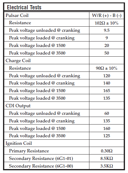

Thanks for that 99yam40. I found a couple of useful Dangar marine videos explaining troubleshooting the cdi system, and also one on building a DVA. I'm sending for one rather thn building, since the cost seems to have come down enough to make it worthwhile. I have some specs for the DVA voltage and also the static resistance on the trigger and charge coil(s). I guess you have to just assume the CDI unit is at fault by a process of elimination -- essentially testing all the coils?
I don't have specs for the CDI's output to the ignition coil -- as a guess should that be something near the output of the charge coil? In my case the output of the charge coil should according to manual be > 110V. So I'm guessing the CDI output to the ignition coil should also be that or better. I'm guessing the CDI unit doesn't step up voltage, just charges a cap with what it gets as a peak from the charge coil before sending that to the ignition coil.

Thanks kindly boscoe99. After I received my DVA converter I checked out the readings on all under-flywheel coils and the ignition coil. They were all within acceptable range. I changed out the spark plugs. Still No-go. Finally the replacement CDI unit I had sent for arrived. Replacing that restored the spark, and the engine now runs perfectly again.
I'm glad I do have the DVA now, and can check for any problems in future by not just throwing ignition parts at the system, but performing meaningful troubleshooting in advance. I thank all who responded in this thread -- your help was invaluable!
