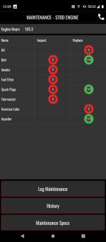

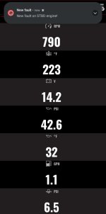

I bought the last version of vessel view and you can see all the gauges info in one screen as well as the maintenance the hours of the motor and helps you to have everything in the same app. respect the fault found shows you the current fault when you connected and not historic faults.
the faults is showing like photo 1
maintenance scheadule photo 2
and the gauges you can read like photo 3
(im currently having a overheating problem)

The 521-20 is a fault/warning message that the engine got too hot. It does not mean that the sensor is bad though . . .
If you want to get full diagnostic info, find faulty sensors, etc., then VesselView will probably get you only part way there. For same/similar money you could get the Rinda Diacom software. That is certainly what you mechanic needs, not V-V.
