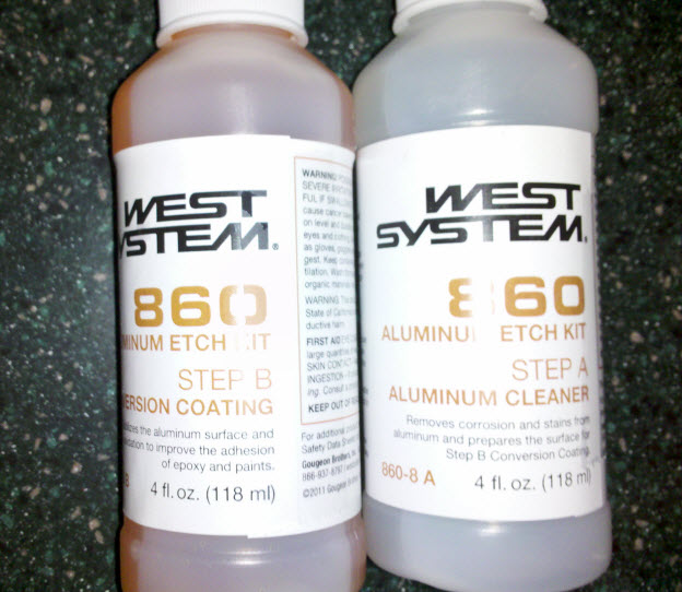

To ensure that my filler adheres, I etched/cleaned the aluminum (phosphoric acid etch) then passivated it (chromate conversion). This is basically the Alodine treatment pros use for priming aluminum for painting. I used the West Systems 860 etch kit since i had it left over after a previous build.
