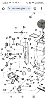

I source new ones, put them on the engine-facing end of the thermostats (seemed like a no-brainer) and reassembled. It ran much cooler at this point for a trip or two, but now I'm finding a hot block at the end of the day again. Not hot enough to set off the alarm, but I need to remove my finger after 4-5 seconds.
I double checked the parts-explosion pic online, and I'm now seeing that the seal (#26 in the pic, a rubber covered metal washer) seems to be installed "between" the cylinder head, gasket, and the block!
Can someone please confirm or deny this?
If this isn't the case, the original seals could've easily fallen down into the water jacket when removing the thermostats, and could be providing restriction of water flow causing my intermittent overheating...
I have a full engine gasket kit on hand, and can easily pull the heads and rectify this, should this be the case..
Any direction or advice would be greatly appreciated!!

I really just need to know if I've got the seals installed in the right place. If so, then I'm thinking the originals may have fallen down into the water jacket, due to my ignorance. I simply didn't know they were there lol.
There's a guy on YouTube with the 150hp 60⁰block from the same model year who posted a vid changing his thermostats, but I saw no indication of any seals while he did this. Same style 'stats as mine, same large plastic retaining nuts and springs.
Furthers my suspicions that the seals are between the block and cylinder head..
Just looking for confirmation before pulling the heads on mine.

The orientation is a no brainer on this....shows it clearly in the parts breakdown. Is this a saltwater motor. Somewhere you have restricted water flow.

If you go to the 5 minute mark of this video it should show you everything.
Different block. Wrong thermostat assembly.
I've changed the standard all-metal thermostats on older outboards before, but never this plastic style. Hence why I missed the corresponding rubber-wrapped seal.
I believe your incorrect. Same block and it's the newer style with the round plastic access covers with a o-ring. Other style is at the back near the bottom of the engine.

Turns out I was partially right. Those rubber coated metal gaskets do in fact go between the cylinder head and the block, and upon further inspection I can now see and feel the originals in place. I had been running it with a second set mounted on the thermostats themselves (dummy lol), thinking they were missing.
After cleaning all the old hardened grease out of the orifices and threads (and removing the second unnecessary set of gaskets), I've put a fresh light coating of Yamalube marine grease on the narrow end of the plastic thermostat housing (that goes into the head through the rubber coated gaskets) and the O-rings on the large plastic nuts, and buttoned it all back together.
