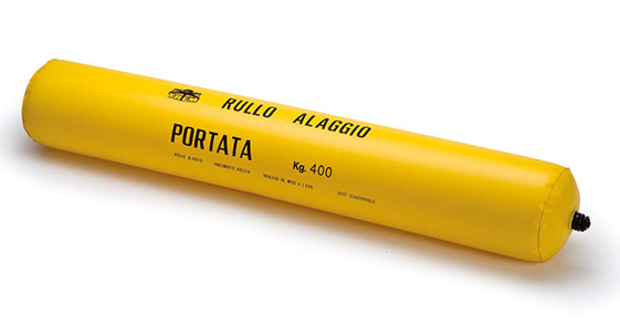

I just found these online. I'm wondering if they will hold up if I buy 6(3 for each side)
