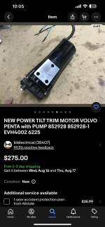

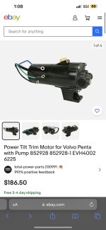

Hey guys my trim motor and pump have given up on my 1976 135 and I cannot find a new pump anywhere, I have found this pump that seems to be the arm dose anyone know of have any recommendations? Thanks!

I believe you can adapt the Mercury / Mercruiser pump and reservoir.----The one that mounts inside the boat.

A couple of online places have pumps, however there were a couple of different pumps used that yr.
