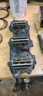

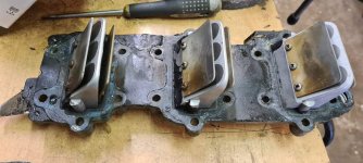

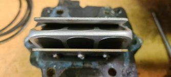

I now checked the Reed valves. Pictures attached. To my surprise, valve 2&3 (counting from top down) have tiny gaps, enough to see some light anyway. But not number 1, which is at the carb that spits fuel backwards. Strange to me.
All looks clean and in very good shape, sealing was ok. Ideas, anyone?

If its spitting fuel out the idle jet it is highly likely it has scuffed exhaust side of piston due to bridged port.. and compression will be fine

Q1 Do the reed valve gaps pictured seem normal? Can't see the gaps unless using the backight method, so probably just 0.1 or 0.2 mm or so.

If engine internals are in mechanically good shape, no. Reason being that when piston starts down stroke the crankcase pressure will push them shut. Also it wouldn't idle worth a dang if reed/s stayed open.
