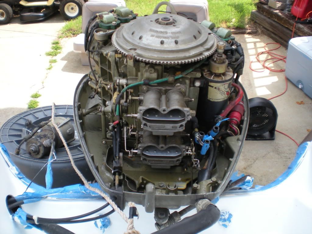

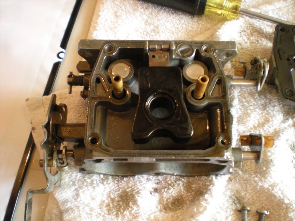

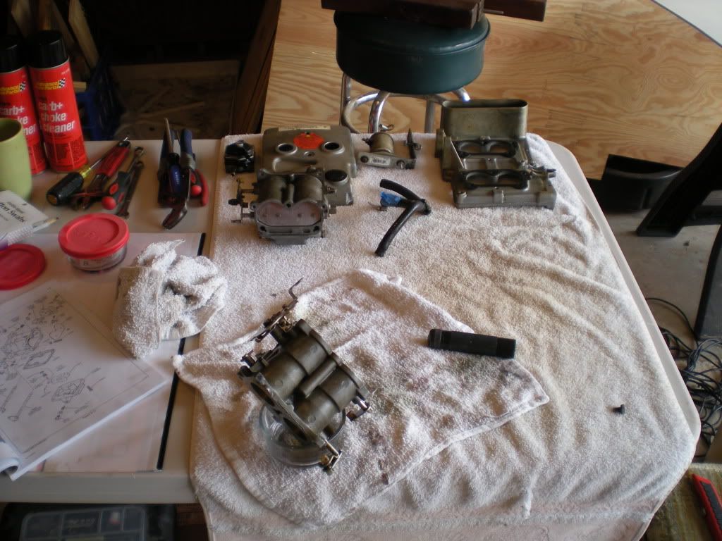

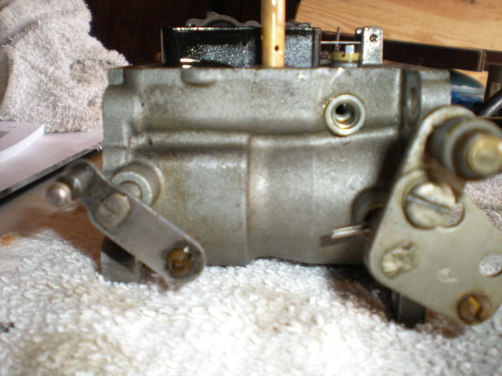

Last time I tried to start her it sounded like she wasn't getting fuel, couldn't keep it running without spraying direct into carbs. Figured I would discount most probably fuel issues before the hull is done and I try again.
Remarkably clean for a 75

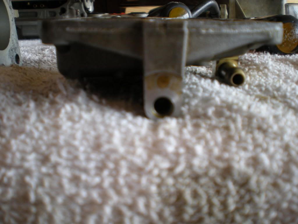

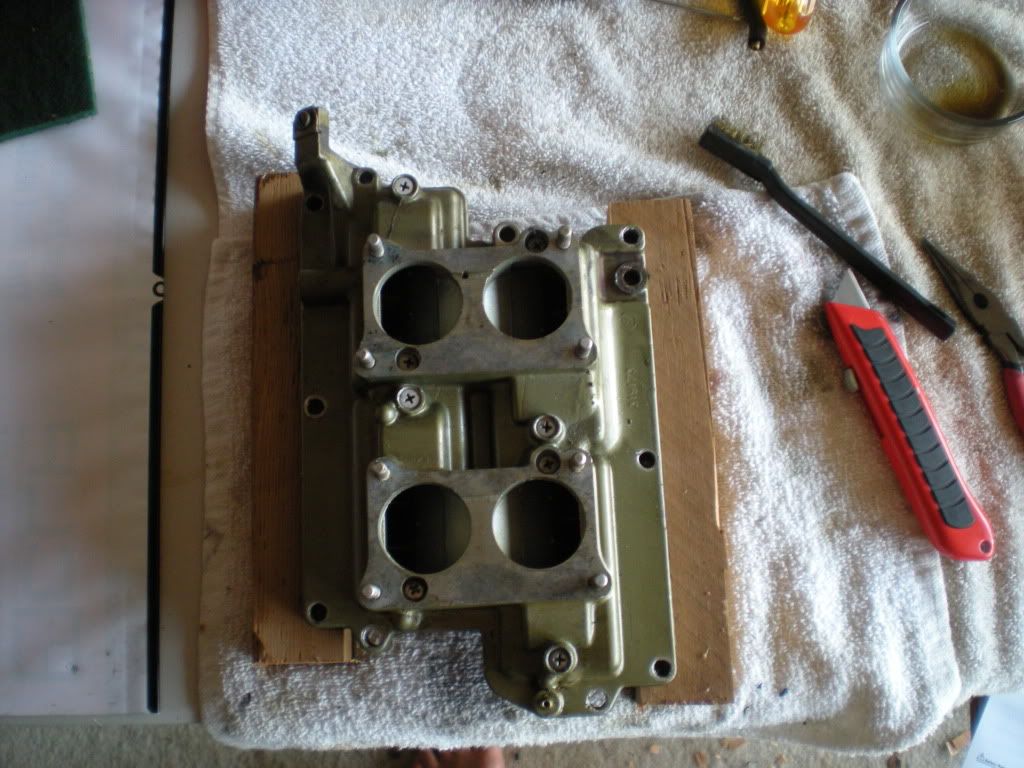

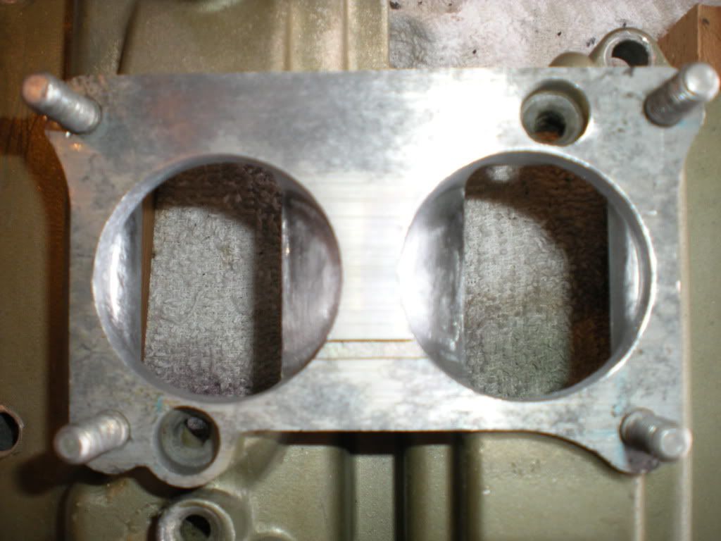

Notice the ridge left and right
Ridges removed and casting smoothed

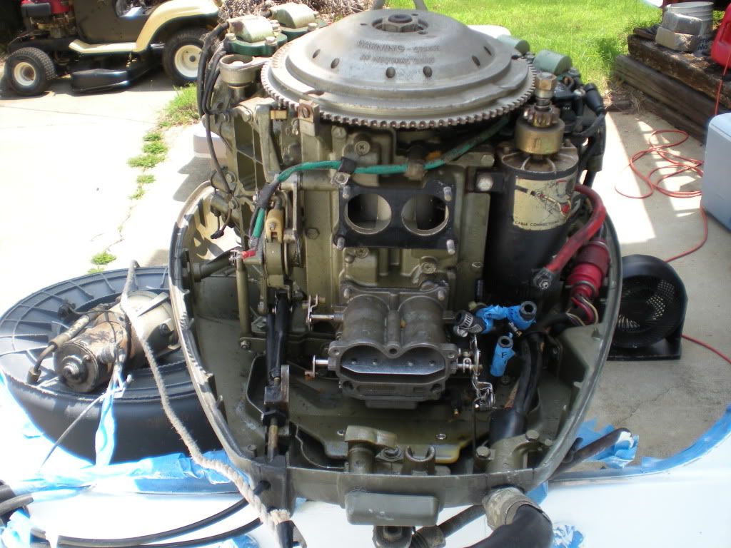

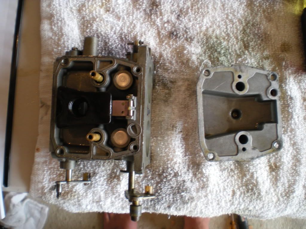

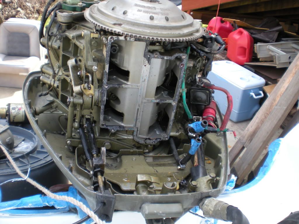

All back in, new gaskets, rebuilt carbs and new fuel lines. In terms of fuel, spark, O2, that should take care of the fuel part. I still can't believe the carbs were in that good of condition.
