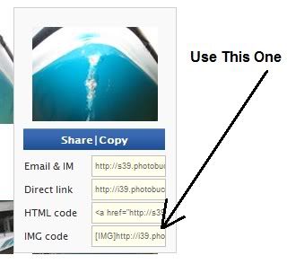

Faithful.
In photobucket, if you hover over your pics, the following drop down will appear. Click the IMG code and then paste it into your iBoats post and the picture will Directly appear in your post instead of the link. Works a lot better for us to see your pics.

Faithful.
Thanks for that tip! I didn't know you could do that from Photobucket. I took so many pictures and wasn't sure which ones were needed....don't think it would be appreciated if I put all 66 of them in my post. :eek: I will use this to post pictures from now on...thanks!
