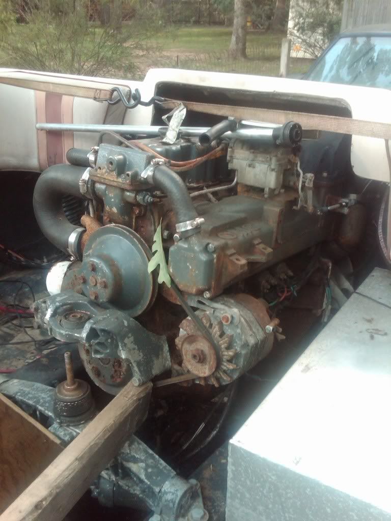

4 cyl i got a number of 252strhcom and a serial number 401120 and the motor says omc and i think on the inside of the head i seen gm so thats my guess
not to come off sounding like a **** but i did post all the info i could lol, but yea its def a gm motor i seen it on the inside and side of the block, and those were the number i have, and the HIN number was posted in a later post pics in a few minutes

Most likely the GM based 120-140 Hp. inline 4. I know i`ll get stepped on but FOR TESTING ONLY ,you could get away with it .

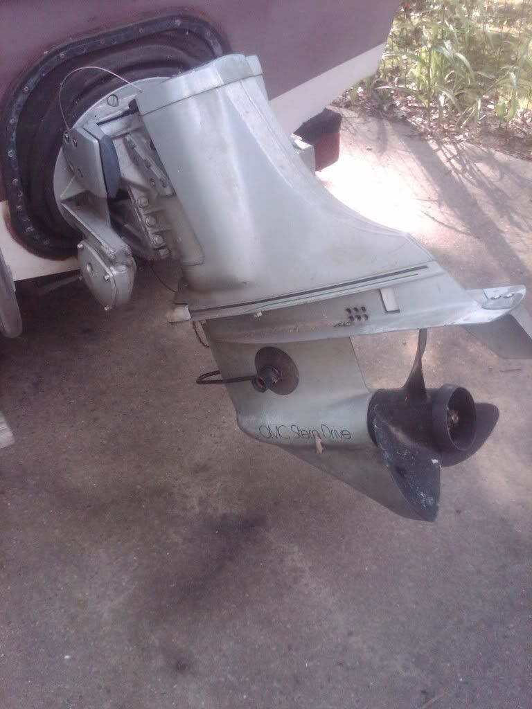

Omc Drive & engine. Never run it above idle with the prop not fully down. Bad things will happen !

from the numbers i gave can n e one tell me what liter it is so i can search and get the right starter

From what I can tell looking at my Selco manual and trying to compare pictures in there to your photo it is a GM 2.5L or 3.0L 4 cyl engine.
I see that the engine compartment is pretty open. If you take precautions like making sure you have no fumes building up you should be able to have tried the automotive starter but as has been said this is not something you want to do beyond a test.
There was another good comment here about the drive. The OMC drives have their transmission in the bottom of the drive so the engine is connected and a shaft is turning all the time in the stern drive. You never want to run the engine with the drive tilted up or you put too much strain on the universal joint.
You should also check the fluid in the sterndrive. (Caveat: the following is correct for my OMC drive. My manuals indicate it would be the same for yours but I cannot tell from the picture you have)
On the top of the drive you should see what looks like a big screw head. This is the dipstick for the fluid for the stern drive. Unscrew it and you have a very short dipstick (1-2 inch).
If you do not have fluid in the drive you probably do not want to start the engine or you could damage the drive.
Hate to see you get it started only to create a problem in the drive.

Thanks for the tips I'm gonna order the starter tday and install next week

Here is my 2 bits worth, do you have any one that rebuilds starters and altenators handy as this could be cheaper?
since you were able to turn it over by hand you know its not siezed up, so I would start with the basics to get it running before you throw lots of money at it. probably bad gas and filter, pump it out, add new filter, charge battery or replace and clean all the terminals good, make sure theres oil and it is not milky, engine and leg.
clean and set points, check rotor and cap (wipe any moisture/scrape electrodes if lots of build up)
If you then get it running and you are confident in the boat then through a tune up and fresh parts at it.
