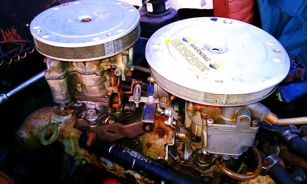

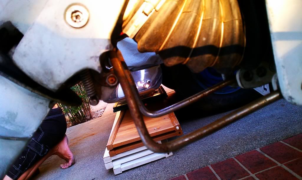

I have a few concerns about the boat -
Im assuming this is where I put the clamp thing with the hose to start it while its not in the water. Any suggestions on this? Is it bad to start a boat with no water running through it? Why? Im assuming water runs through this to cool the motor. Should I just wait until I get it to a professional to mess around with it? Ive seen people cleaning out their motor before like this. I started it for just 2 seconds today to make sure it would fire up and it did on the first turn of the key with no hesitation. Did I do wrong by doing that?

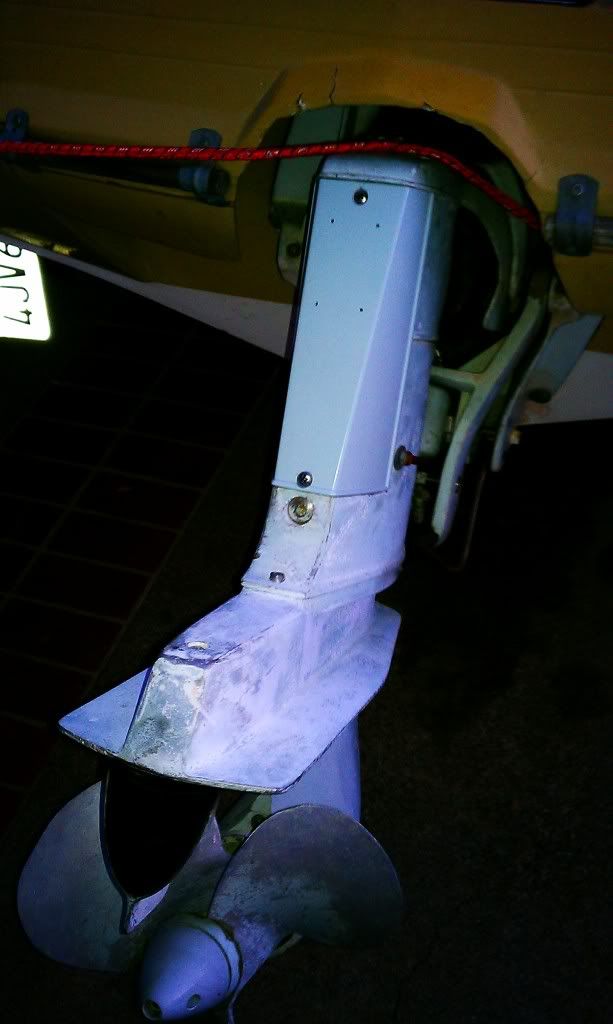

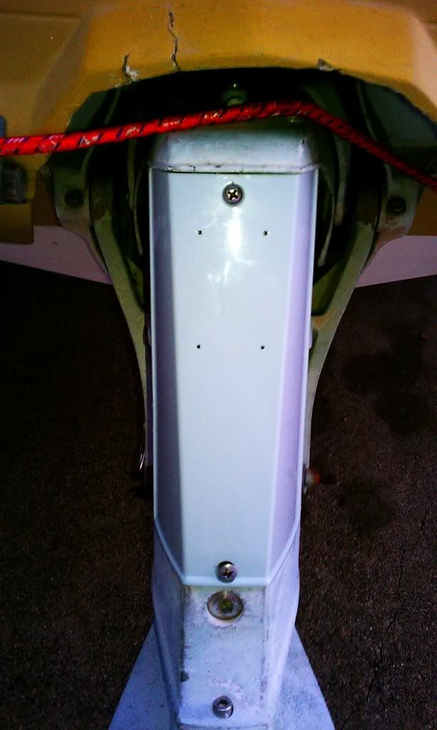

Is there a part missing from what you see in this picture? Should there be two of those metal arms connecting to that part above? Also the propeller spins freely is that good or bad?

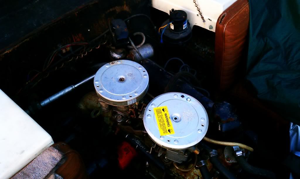

This looks like its jerry rigged. My uncle said it looks like there was another piece there that was in the grooves and I agree. There are also no bolts holding it in the holes as you can see in the second picture.

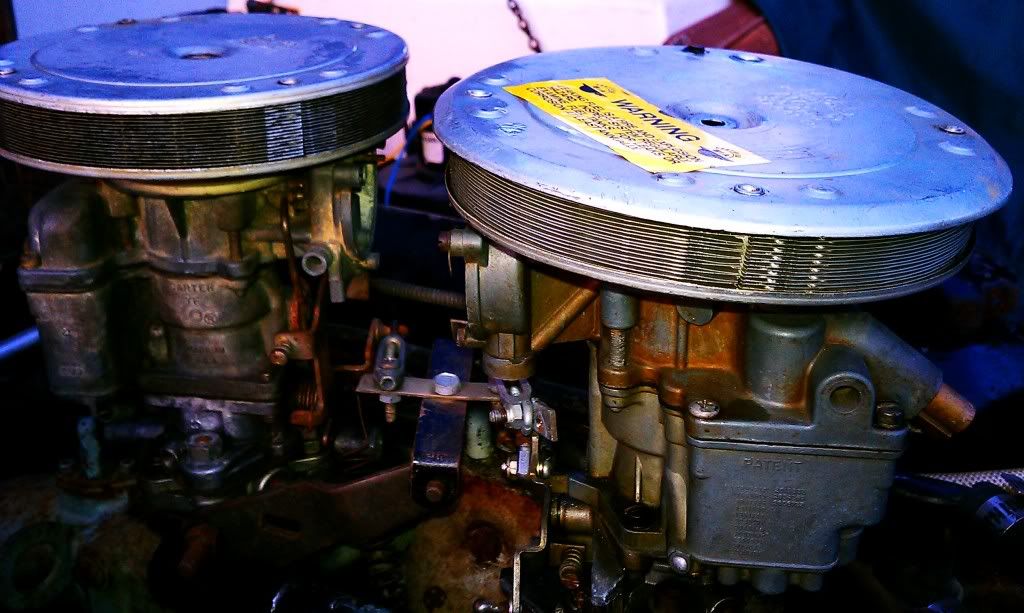

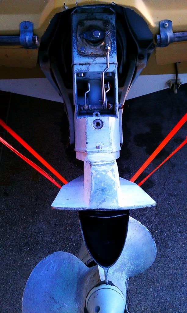

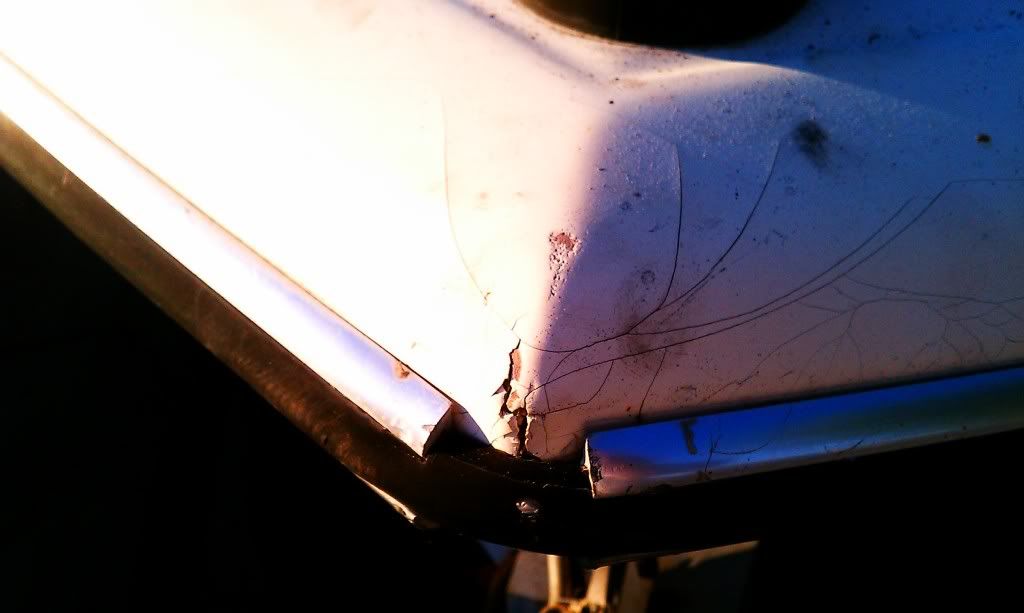

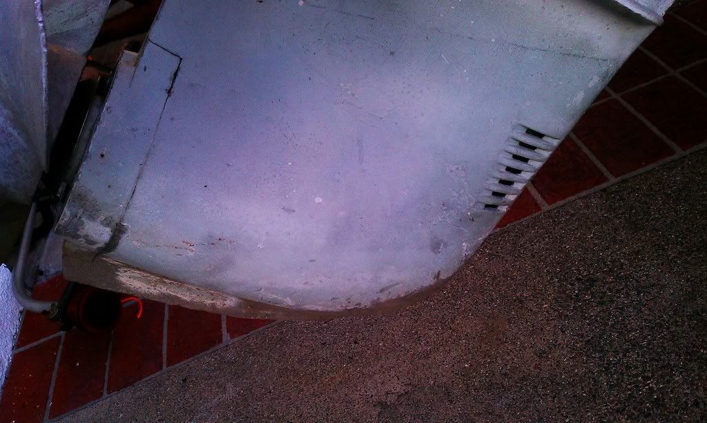

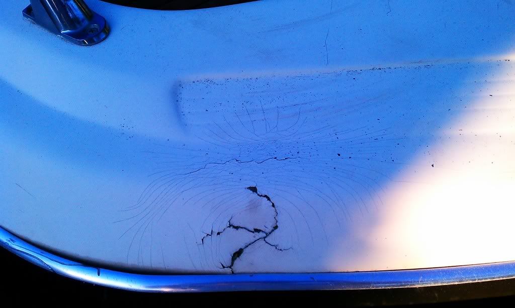

This is where someone bumped in to something. The guys I got it from said it was easily repairable. Is this true or is it going to cost an arm and a leg? There are 2 right next to each other in the front of the boat (first picture is the front most part of the boat where it comes to a point and the second is about a foot to the right of it)

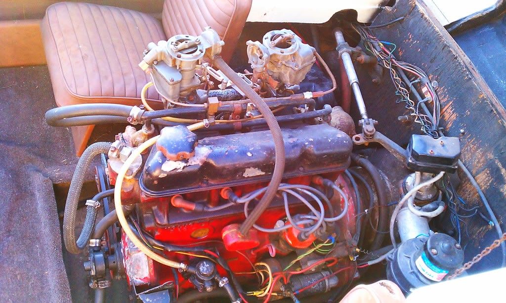

Does everything look complete here to you? My uncle might have said its missing something on the carb (I cant remember the name, Im not a mechanic).

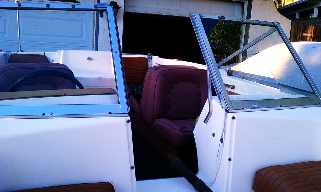

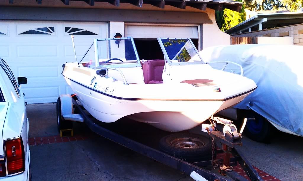

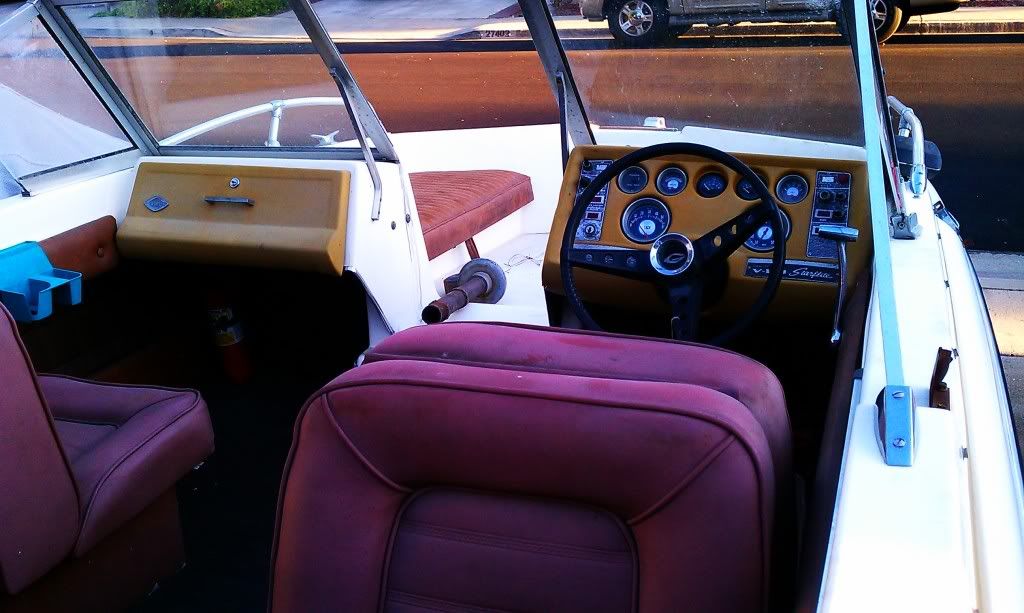

Here are some more pictures of the boat

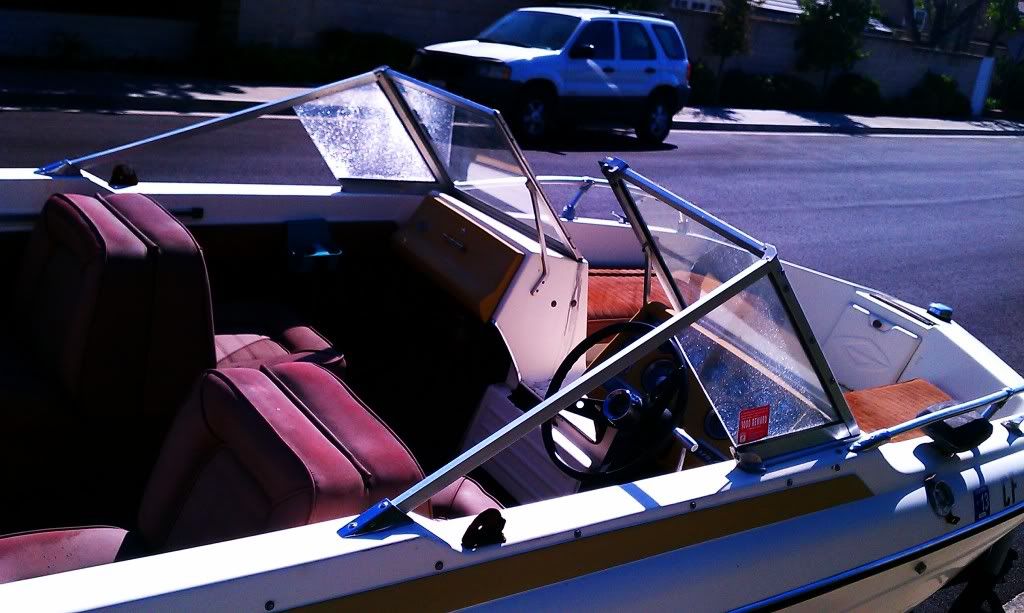

Its missing the middle window also.

I had the same boat for about 20 years. I'm no expert but knew my way around it pretty well. Your engine looks to be the same as mine - Volvo Penta AQ130C. First - I'll try to answer your picture questions.
The first pic - yes - that is where the muffs go to run the engine out of the water. Without making me resort to a long answer - just DO NOT run your engine without either muffs or being in the water. You probably did no harm but dont push your luck.
2nd pic - no you are not missing a piece there. That is the linkage which determines the rotation of the prop. If you change sides that the rod is mounted on, it reverses the prop rotation. Do you have the cover that goes over this. You have to have this before you use the boat.
3rd pic - That support under the outdrive is not 'jerry rigged'. That is how it is supposed to be. You simply push the two sides together to remove the support when you are ready to launch. This is simply a support for the outdrive while trailering.
4th pic - Hull damage - This is the area I am least knowledgable. Fiberglass work is expensive if you have someone else do it. Not so bad if youdo it yourself - kind of depends on how good you want it to look. You can likely do a structurally good repair but it may not look to good.
5th pic - Those are Carter carbeurators. The AQ 130C had twin downdraft Solex's. Either someone put the Carters on or this might be indicative of one of the 'other' AQ 130's designations...not sure. As for something missing - you MUST have flame arresters (they look like metallic air filters but are MUCH more important. You don't want to go BOOM! I dont know Carter carbs at all but it looks like you might be missing the chokes as well.

Let me see if I can catch a couple of things to help out here:
First photo - those are your intakes, and yes the muffs go on there. I don't know how hard that is on that drive (looks a bit tricky). You can run your engine for a moment or two without water running through it, and you won't likely hurt it. But get into the habit of tossing the muffs on before you start up, these engines run higher RPMs than they would in a car and need to be kept cooled.
Photo #2: Need a Volvo guy there. Looks like you're missing a cover, but I've got nothing for you on the rest of it. I don't get the clamps and metal bars on the left and right at all.
Photo #3: I've got no clue.
Photos 4 & 5: Ouch. Those particular hits are in the top, and themselves don't compromise the hull. But, being on the point that whack went right down the keel. Have you had a pro take a look at it at all? It might be worth taking it to a local marina and (even if you've got to pay someone $40) have them look at it. It's fixable (plenty of restoration threads here in the forum to help), but it's a lot of work.
Photo #6: You're missing the flame arrestor on the carbs, but I'm not skilled enough to recognize more than that from a photo.
Last set - missing your middle window is not too big a deal. Mine is open most of the time anyway. The windshield supports look okay, and that's what is doing the heavy lifting.
Thank you very much, I needed to know that! I havnt messed with it at all yet.
No I dont have a cover. Should I search for aq130c parts? Any tips on finding it?
haha Nice okay thanks, I was just making sure.
I have been reading and watching videos on the subject since I joined this forum. It looks a little complicated but maybe not too difficult with a little more knowledge? I will get an estimate first before I set out and potentially ruin my boat.
Is there any place I can get a manual (hopefully free) or schematics to the motor. I am no mechanic but I can use it to see what I need.
No I will be taking it to the professional though soon. I better do it while I have the money lol
Any idea where to find them?

So today I went and got the flame arrestors and a shift linkage cover. FINALLY!! I found a guy 20 min from me with a bot junk yard type place. Its called outboard exchange in costa mesa. They literally have hundreds if not thousands of outdrives and parts for them.
He had a brand new shift linkage cover and a box of flame arrestors (most were too big for my boat). Grand total of $170 for 2 flame arrestors and shift linkage cover!!! Now I just need to find the bolt/screws that hold on the flame arrestors and maybe get a 1/4 in shorter bolt for the linkage cover and Im set.
