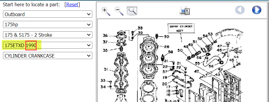

1990 model year motor. 30 years old now. One of the best that Yamaha ever produced.
The D in 175ETXD denotes D for the model year. 1990. Used again in 2005 but for different models.
Leave the oil injection system alone. One of, if not the, best made. The linkage referred to relates to how much oil is provided. If the linkage gets disconnected the system will default to the maximum oiling mode. You will know it by the amount of smoke or maybe carbon build up on the plugs. Easy to inspect the linkage.
