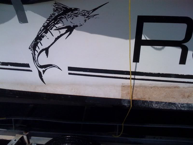

This boat had been sitting in the water for quite some time and has accumulated a hefty amount of barnacles along the bottom of the hull. I have heard that pressure washing is a good way to remove barnacles, but is there anything that I can spray on before hand that will make the barnacles come off a little easier??

Ayuh,... You're going to find that a Putty Knife will be the 1st tool you'll wanta start with...

It got bottom painted from the photo, I think you'll end up sanding or soda blasting the remnants, they stick like stink.

Yeah I was thinking I would start with some good scraping with a putty knife. So would a pressure washer help at all in this situation? Or do I need to just skip that all together and bring out the big guns??

If the black is bottom paint they'll take it with them, if its black gelcoat they'll have to blasted off. They took the paint off my outboard skeg.
Its like trying to sand oyster shells.

Ahh...ok I understand now. Im not sure if its paint or gelcoat on the bottom. How can I tell??

HaHa...Well, I sure hope so. I began scraping off the barnacles yesterday and then I did a little wet sanding to bring back the gel coat. It seemed to work pretty good. I'll post pics later on today if I get a chance. Im about to begin another day's work on her.
In the picture I posted in my last post, you can see that the gouges are so deep that they seem to have penetrated the gelcoat and dug into the glass just a bit. Is a repair like this going to require me to lay some fiberglass down first, or can I get away with just a good dose of gelcoat to cover it??

Grind down to virgin glass then go back with original material, if it was matting then do the same and build it back til almost flush, then gelcoat with milled fiber, sand that then finish with gelcoat and sand til you're sick of it.

Alright...I had a super busy weekend so there wasnt much time to work on the boat. But I did manage to begin the cleanup process. I began by scraping off the barnacles with a putty knife. It was a very slow process, but really worked well. The barnacles took alot of the color with them so Im going to be looking into new gelcoat for the bottom. However, I'm not sure the bottom is gel coat. Its almost like a gigantic decal...Any ideas???
After scraping for a long time, I did some wet sanding on a small section to kind of test my abilities and the outcome was good. I started with 400g sand paper because 600g was simply not cutting it. The gelcoat immediately started to come off as soon as I started sanding, but I had to sand real deep to get the stains off. I am not sure how deep I can safely sand, but I want to get rid of the stains completely. Is it safe to just keep sanding until the stains are gone??
I took a couple pics of the work I did and seperated the section with a piece of tape to show the difference between what I had and hadn't done. You can see in the first picture that I didn't completely remove the discoloration. I would like to eventually remove all stains.
Any thoughts or suggestions will be greatly appreciated...Thanx.

I don't know about doing a gelcoat except in a mold, painting with it is a different kettle, it doesn't go on smooth like paint at all.
It will take some sanding to smooth it out and its not the easiest thing to sand. If brushed on ther brush marks remain, it doesn't flow like paint, its err..gel.
The previous owner of my boat brushed glecoat on and it was so bad looking I used an angle grinder to knock it down then painted it with marine paint.
I suppose it depends how deep you go to remove the barnacles, if you don't peirce the gelcoat then bottom paint might be an option.
