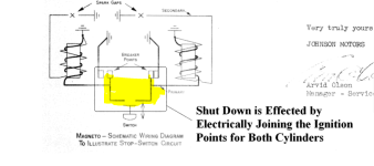

When key is turned to OFF----The 2 " m " terminals are connected.----When your kill switch / lanyard is activated the 2 wires on it would connect the 2 " m " terminals.----Not much to it really.

39,900
The idea is clear.----The 79 model 85 does not have breaker points.------The kill switch connects the 2 " M " terminals to stop the motor.
Crosbyman
Nov 5, 2006
6,232
I understood that ...we are dealing with a concept and now a "modern" solution of shorting 2 M wires
M's that formerly went into the Magneto.
