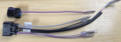

Then there is another thing that confuses me. I got this wiring plan that looks like it would match to my module. After hours of searching I also found the numbers of the wiring harness and ordered both in the US.
This plan shows cable number 6 for Audio warning system. This wire is missing in my original Mercruiser plug. Does anyone know why ?
Today the water temperature swith and the oil pressure switch are both connected directly to the buzzer. So if I connect the water temperature switch now to wire 8 how will the Audio warning system work if there is no wire to connect it ?

So the new unit will be installed on the exhaust ellbow and I will make this part of wire harness new. Many years ago I became an electric engineer, so I can read wiring diagrams and to build a new harness is not a challenge. I also do not like this round 1 pin connectors everywhere in the boat. Wherever possible I cut them off and replace them with waterproof connectors. So it is not a problem if my kit is not complete.
Coming back to the knock sensor. I found one post in this great forum here which contains numbers for a module and sensor on the V6.
But the ECU number is completely different even though I understood it is also a Thunderbolt V. Do you think this combination of knock module and sensor would also match with my ECU ?
I also found this page, but my trust in this information is limited as they list my module as TB IV instead of V.
It says at the beginning
The Knock Module monitors the Knock Sensor's AC voltage signal
and supplies an 8-10 volt signal to the ICM if no knock is present.
Do all Mercruiser knock modules work the same ? If yes, I could choose anything I can get as the ECU should not care where the 8 Volts come from.
About the audio warning I have new information. After some hours with google I found a service bulletin that looks like it refers to my ECU. It also contains a wiring diagram where the cable colors do match with what I have. Here the port for the water temperature switch is not connected to the ECU but directly to the alarm buzzer like it was before. I don't see a reason for the Tan/Blu wire being connected to the ECU, but maybe the ECU does something when an alarm is triggered or it can also send an alarm, even I do not know for which event. At least my original cable set has neither a Tan/Blu nor a yellow cable. I jsut thought from the setup of the other plan that I posted before that the ECU would need this signal of the water temperature and would shut of the engine or reduce power on overheat. But this all doesn't seem to be neccessary.
So if you think that the numbers in the above mentioned post for knock module and sensor would work with my ECU my problem would be solved and I will start to search for those.

I believe it would be easiest & best to just continue using the old warning system design vs integrating into the TB-5 design as there have been some reports of unexpected/unexplained warning horn faults going off for no apparent reason which have been linked back to the ICM/Yellow temp wiring system. No need to add an extra potential issue.;)

The comments of Chris that the V6 TB-V modules might not have the internal circuitry to connect the sensor makes me rethink the knock sensor project again. Also there is not realiable way to test this as I hope that, with todays fuel quality, it would never enter into a knocking state. The lowest fuel you can get in Europe today is 95.
So I will think about it again and if I find the parts for a reasonable price I might add them. Even if I know that most probably I will not need it. But it makes me feel better .... :)
I have some more weeks of time as I had to take out the wooden block where the fron engine mounts are screwed on to. It was all rotten and I have to make something new. So until then I have time to think.
I will also leave the audio wiring system as it is and not connect the ECU.
