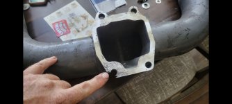

Pull the drive and look in the exhaust port for signs of old flappers or other debris. The surfaces should look relatively smooth. Then put some water flow with a hose in the exhaust outlet (not so much that it goes up the risers and into the exhaust manifolds) and look for any water coming into the boat. The water should only come back out the exhaust outlet.

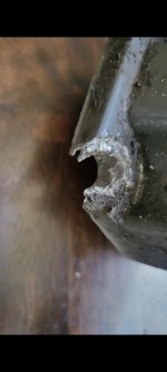

Exhaust pipe flange was broken on one corner so I'm bleeding that was it. I got it welded and new hole drilled. Put it back on torqued to 50lbs. Really didn't feel to tight but left it at 50lbs. New oring seal and gasket sealant before seal on transom assembly flange , on seal and on exhaust flange. It's still leaking just half as much. Did I over tighten it or do I need to tighten it more. I do have the 1990 omc so I might be wrong but I believe on this year I csb go tighter due to having helocoils on this year. Correct me if I'm wrong

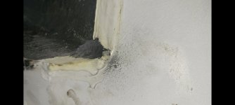

Ok so half the issue was the exhaust pipe obviously but I found under very close inspection a pin hole on the bottom corner of transom assembly. Wasn't sure it was leaking there till I had my daughter blow compressed air through it and I could see air flow from inside so if air is getting through water obviously is. So I think I finally narrowed down the last leak. Instead of buying a hole new/used assembly I'm just gonna use a dremel out the hole a little bigger and scuff it up then use JB Marine Weld to fill the hole and feather it out on outside the after that cures cover that with 3m Marine adhesive sealant 5200. That really should take care of it for as long as I own it. And if the 5200 ever gets compromised I'll just reapply or if need be buy the assembly then. I'll keep you all updated.

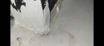

In these pics I first dremeled out the pin hole very slightly so I could push some Jb marine weld through the hole and then cover outside. Let that curw for a day and the I added a layer of the 3m marine adhesive 5200 (fast dry version) should be ready to get wet in 7 hours for hopefully the final leak test

Finally No more leaks. So to recap, there is two faults, one pinhole in the bottom right corner of the transom assembly. And a broken nut on the bottom right side of the exhaust flange, both contributed to the leak. It did have a small leak when I bought the boat which Was originally probably the pen hole. I just wanted to make sure I came back and gave the final outcome. Too many time these threads get started and the OG poster never gets back after they fix it. The whole purpose of these forums are not only to get help for yourself but to help the next person who might benefit from you trials and errors. God bless you all.
