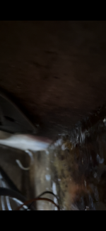

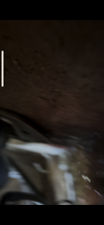

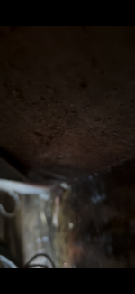

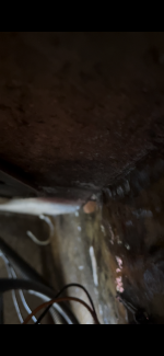

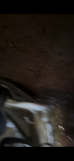

Had water coming in and replaced bellows and just took it out for first time after and still getting water in? Any other places water could be getting in? Seals or o rings etc....Posting a few pics and try posting video

rotten transom
since you mention OMC, the newest OMC is 23 years old and those were relabeled volvos, most OMC;s are much much older (coming up on 30 years old)
have you test drilled to see if your transom is wet/rotten?

On the Cobra the shift cable bellows is at the top of the tube that screws into the bottom of the transom mount and is routed up in the engine compartment. Follow the shift cable back and you’ll see it. In my experience these rarely leak. That tube will actually have water in it but it’s routed up so the end where the shift cable comes out is well above the water line. Just like a Volvo SX (VP copied and adapted the OMC design).
What did your gimble housing flange look like? Corroded? And did you make sure to install the bellows correctly? I had posted some pix of this if you search
This tube can leak where it screws into the transom mount but I haven’t had that problem yet!

Ayuh,..... Rotten transom,.....
I’m hoping not as boat is in excellent shape. Is there any way it’s a seal between it. ??? I’m guessing I need to remove outdrive again and test with water in bildge again to get better look where it’s coming from. Before removing the engine. ? Any suggestions would be much appreciated.
53,057
you must remove the outdrive before removing the engine
if your boat is over 20 years old, high probability of a rotten transom

Besides the water test, other signs of a rotted transom are gelcoat cracks around the outdrive cut out and flexing if you pull up and down on the outdrive hard (careful don't knock yourself out). A few people have had luck with seeing if they can get at the nuts that hold the inner and outer transom mounts together and tightening them. They can be VERY tough to get at, though. Might need a crow foot wrench or similar.
this is the problem with I/Os and why I will not have another. Lots and lots of places to leak water and none is an easy fix.
outboards only for me from now on.

I just went out and inspected bolts on inside of transom and they are a little loose. I can turn them a few times with my 5/8 wrench. I’m guessing these don’t just come loose. I was able to get to the top two and bottom two bolts. And does sound a bit hollow tapping on very bottom of transom inside boat. But only about 6 inches up. Is there something to re harden this taking motor out ? The outside of transom is very solid and no soft areas!!!! Thanks for the help and advice in advance

Ayuh,..... Boats rot from the bottom, Up,.....
No easy button to fix it,...... it needs serious help,......
53,057
the only easy button is a staples sales gimmick
drive comes off, motor comes out, transom shield comes off, you build a cradle, you remove the interior, you remove the cap, you then remove the floor, stringers and tansom.
you then go here. https://forums.iboats.com/threads/how-tos-and-other-great-information.283508/
read threads 14, 15, 18, 2, 3, 4a, and 4b in their entirety. look at every picture. watch every video.
