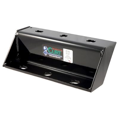

Problem with having it that high is that the coupler doesn't want to rotate as easily and may smack his bumper on turns. If you do need a drop, this might work. Older pickup bumpers always had the 3 holes you would need to mount one of these.
http://www.google.com/products/cata...=X&ei=SdXJTbGXMcjZgQe07tHwBQ&ved=0CFYQ8wIwAg#
