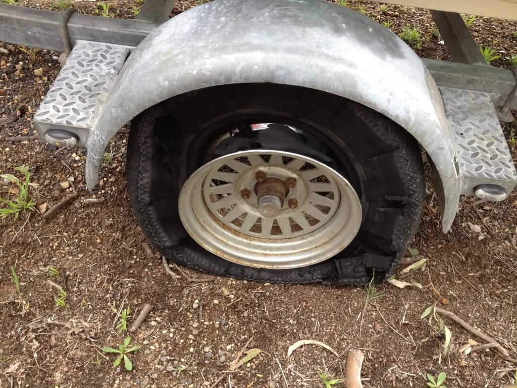

After my weekend away, i cant stress enough the benefits of a) A Quality Tyre and B)Carrying a spare.
300km from home, doing 100km/h (60ish mph) Had a tyre blowout on the trailer:
Leaving me stranded, on a public holiday, with no spare. Luckily, after a 200km round trip, i managed to source a tyre and get it fitted.
Then on the way back went through the same tyre shop and picked up two new tyres and wheels. So i now have a spare >.< 6 ply truck tyres for those playing at home.
