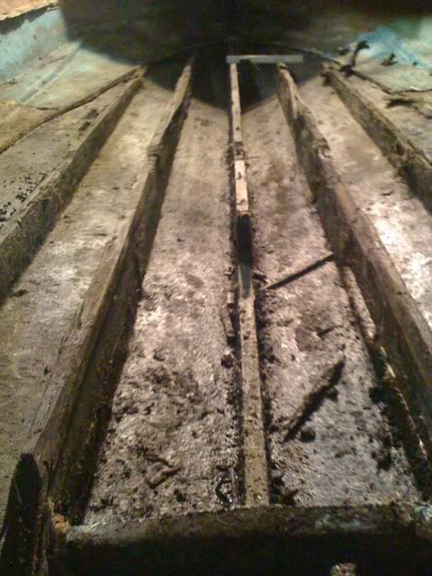

Here are some pics to better show what I am talking about.
The current motor well design:
And how the stringers are cut to make this shape:
THis pic shows the one drain hole from the under-deck area to the motorwell bilge:
There were also limber holes in each stringer. I am concerned that by putting these holes back it it will actually allow more water in the under-deck area, such as normal deck runoff from swimming and the like, and may be better with no limber and drain holes, and filling with foam instead.
Any thoughts guys?
Thanks!
Terry

Re: Limber holes when filled below deck with foam?
Water will get in there...... just a fact
Put limber holes in so if any gets in ....it will route to the bilge.
Many people use the edge of a plastic spoon to insure smooth rounded edges on the high side of the stringer leading to the holes.
