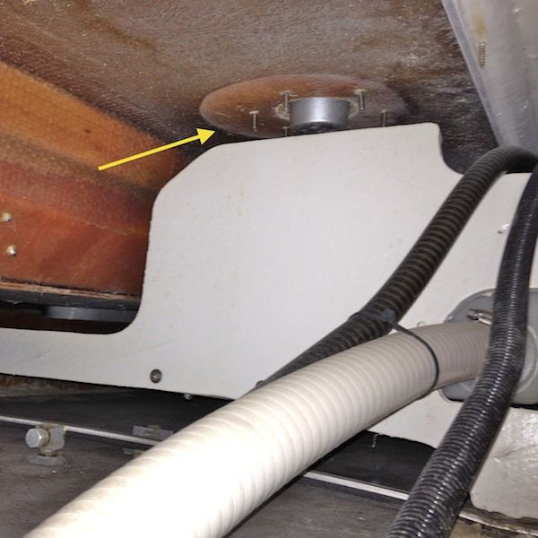

I would get the flush mount table base, as anything that stuck up would tend to be a toe-breaker. Drilling into the deck is not so bad with a hole saw and then just seal the edges with epoxy, etc. you will have to look at the space below deck to see if there is about 2-3" of clearance in the area where you want the table.
Post some picture of the below deck area as viewed from the engine compartment forward. If I can find a picture of the table base on my boat, I will add it to this post. . .
Here is a view of the flush table mount base from my boat . . . you'll need a few inches of clear space below deck for the base and screw projection.
If you don't have the clear space and have to go into the stringer box, then it gets tricky . . .

Thanks tpen and Slip. The pic really helped. The Monterey guy called and told me the dimensions and thickness of the deck and now I have a plan. Based on the great advice I got from you guys, along with the info from Monterey, I'm definitely going with the flush mount. I just wanted to make sure there wasn't anything lurking under the floor there like a wire bundle or something, and now that I'm assured there isn't, just gotta get a hole saw and drill away!
Thanks again guys, and boat safe!
