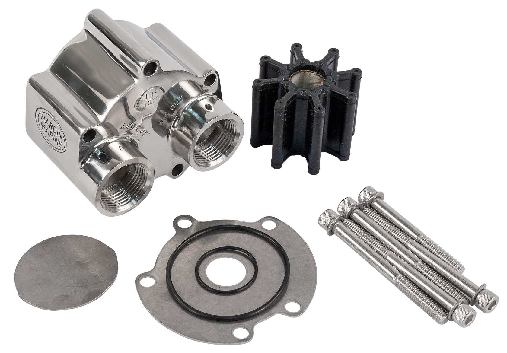

lol ran into a bravo needing the impeller replaced today.. man oh man how I wish they were in the drive. Down at the very very, all the way down starboard side. plastic housing, don't bust it
Yeah, you'll do that once..........
I busted mine, and then installed A stainless steel housing!
No more breakee!

I have been wanting the Hardin housing for mine. The Globe impeller would be a great add on. That should last awhile.

BTW, if you get the stainless housing you also need the hose fittings.

There has been a few threads on the run dry type and what I remember (suffer from CRS) but they work very well in Alpha's not so well in Bravo's.
you do indeed. I used brass fittings.
After having the housing break at the lake. I'll never go back to plastic!
