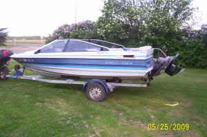

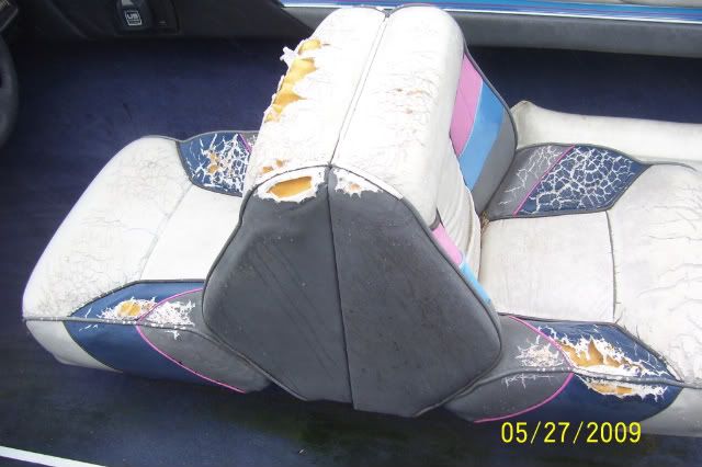

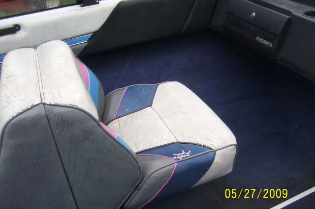

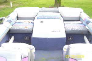

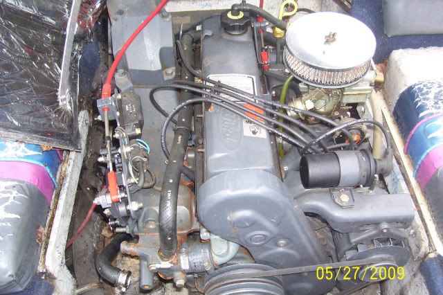

Ok I will try to check all of that out. Thanks for the input. Here are a couple pics I got from the owner. Let me know what you think.
