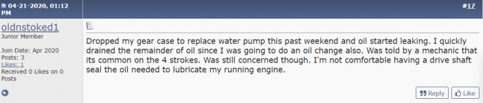

Any idea if this is a seal and I can just pop it back together ? It doesn't look like anyone else has had this issue.
Faztbullet
Mar 2, 2008
15,938
Well you have a Yamaha powerhead built for Merc and they do this as the driveshaft seals the oil pump...so yes this is my best advise .
ok. Thank you Faztbullet. I am just a little leery knowing that my 15 Minute fresh synthetic oil dumped out within 30 seconds. Any u tube vids with the same engine did not do this or even mention it in the videos showing the lower unit removed and replaced, with no issues.
