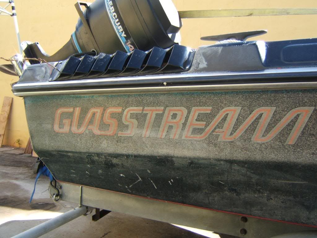

When I first bought this tub, it had a 1980, or so, Mercury 140 HP Tower of Power/ or trouble...depending on how you look at it...
The few times I had it out fishing...before I let all the factory smoke out of it...it would read around 50-55 MPH on the speedo...and that was when it was rotten and water logged...yeah, it definitely was a performer...I had the power head rebuilt and it will be hanging on the back again...I figured since this was rated at 140 back then, which was calculated at the crank...it probably puts about 80% of that into the prop...:D
This is a shot of it back when...
