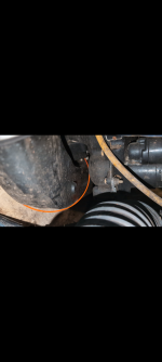

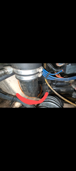

Hi all, back again with a new thread.
This time I'm tackling the lower shift cable assembly. I actually did research ahead and ran a fishing line as a guide, but when backing the old shift jacket nut out the tension sucked it right back in.. it was crazy and I felt all hope slip from my hands. I have extremely limited access on this boat - even less than usual so it's been interesting. Anyways, here we are and I've routed some string trimmer line as a guide but I don't believe I have it under the rear starboard engine mount as recommended. Maybe someone could shed some light here, is it supposed to go on the other side of the starter and then around the Y pipe? Or is it OK the way I have it here in the pic? (See orange string trimmer line in pictures). Any insight is welcome and appreciated.
Thanks!

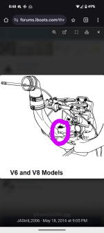

I was going based off of this image but then realized maybe I missed going around the starboard rear engine mount. The part I have circled is the area in question as it seems it's very difficult to see the mount. And in the picture it's cut off so I didn't even realize it at first.

Pay no attention with the rear engine mount
That makes me feel better! So in other words, the way I have it should be fine?
Thank you!
Edit: also, I imagine the protective sheath goes right where it's in contact with the Y pipe here?

alldodge
Mar 8, 2009
44,072
Agree
Most folks don't use any protection because it stays cool. Only time it would get hot is when impeller stops pumping water
