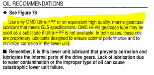

I just got the boat about 18 months ago, looking to change the lower unit gear oil, I don’t have the manual or a manual for it (yet), but does anyone have the correct fluid spec's?
I prefer to use OEM fluids if it’s still made versus using a generic or popular brand (Royal Purple, StarBrite, AC Delco etc) if possible. I’ve seen the Johnson Evinrude brand but it’s for the E-Tec’s.
