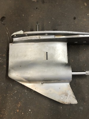

I have a 1995 Chris craft concept 19 with a 5.0 fl Volvo penta with a sx cobra drive, 1.66 ratio can any help me on what lower units will work as I have taken mine off. Thanks F8A64A75-8212-4E2B-8B7D-6BF38C5CDB8F.jpegEF6BD548-5F43-4FC1-A5D0-FFB414745DBB.jpeg

Any Volvo SX-M or OMC Cobra SX lower unit with that ratio will work. I believe a '95 or '96 DP-SM duo prop would also work if you can find it, but I don't know what ratio you would need to change to for a duo prop. Someone here would know that.

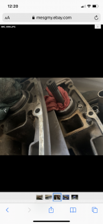

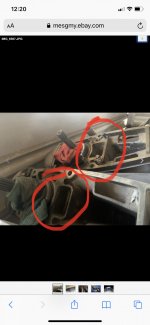

a guy is telling me there are 2 different ones, does anyone know what style mine would be? A copper tube goes there. Really wish I had pulled it apart before going into storage

I think you need 1.66. The other is a ~20% different ratio. That's a lot to try to compensate with a prop change.

Right, but some are telling me that gearing is in my upper so the lowers are the same, need a merc, I can’t find any 1.66 with the same I’m guessing the pipe is a water pick up. They all bolt on and mine just seals up tight.( the copper pipe)
53,059
if its an SX, the gearing in the top transmission is all the same across the board and the gear ratio change from 4-6-small 8-large 8 is all done in the lower gear set.

ok so then how can this be for either or? If the other 1.97 I sent won’t work why would this one?
