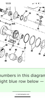

Not so much a guide book but the parts description of the disassembled gear case. Ad the pictures I posted. And okay I'll try the guide pin.

Question. Do both snap rings go into those two grooves behind the reverse gear. Seems the bearing carrier can't go anymore and still not catching.
