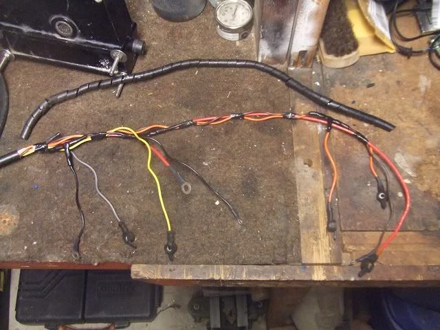

Turns out there was another 3' of boat harness coiled up under the stern cap, so ultimately I decided to do just what you suggested:
All ring terminals and three-way butts crimped and using adhesive heat shrink. Three-way butts then covered in two coats of Plasti-Dip. Rubber terminal covers recycled from old harness. I'm going to wrap this in spiral conduit.
Let's see corrosion get me now! :cool:

Ahh, your new harness looks real nice. I found with my 90 just having the colors be right is very helpful when hooking everything up, plus with less connections there is less to check if something is not working right. Looks good.

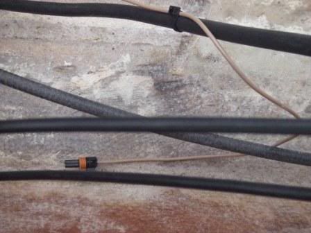

Re-jiggered harness works well:
Did wind up installing an extra wire with a single weatherpack for my temp sensor:
