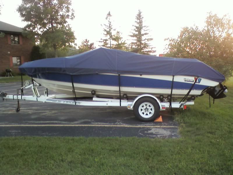

I have a 1990 EZ-loader single axle trailer, with my wellcraft 186 sitting on it..
The dry weight of the boat is 2750 according to Wellcraft, so with fuel and stuff around 3100, and another 750 for the trailer..... I havent took it to a scale yet.... But i can lift the tongue very easily. maybe around 200 pounds of weight on it. As you can see in the pictures the axle sits in the middle of the "weighted" part of the boat, But the trailer does ride smooth, no bouncing or anything.

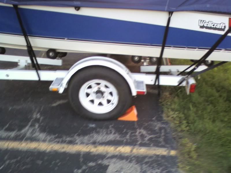

The when driving, the tires look "bent" in and the tires seem "low" on air, but there are pumped up..... The tires are rated for 1750 lbs each, so i am guessing the axle is rated at 3500 lbs... This is the trailer that the original dealer put the boat on back in 1990... so i must be right at the max limit...
My question is, would it be feasible to add a second axle to the trailer.... I am skilled when it comes to trailers... and if so what rating would i get.... I would slide the existing axle all the way back and then mount the new one....That way it wont bounce and make me feel like the tires are going to pop
Or should i upgrade to a heavier ply tire (d-rating) which is 2050 lbs per tire...
I cant go any bigger in rim size because the fender is in the way then....
I guess the other option is to find a old tandem trailer for a 19-20ft boat and use... I want to keep this trailer if i could because it fits the boat with the rollers....
Here are some, pictures.

If the wheels look like the axle is "bent out" I would replace the axle, hubs, wheels/tires and fenders. For your boat, you need ST 225R75D15 tires (65psi) and six lug (5.5" Pattern) hubs . This will give you a load capacity of close to 5,000lbs.
Silvertip
Sep 22, 2003
28,771
Re: Making my trailer more heavy duty
Increasing tire capacity does nothing for "load" capacity if the axle is still rated for 3500#. The axle, springs, and tires are the items that when combined create the load capacity. All three must have the ability to carry the load. You also don't just bolt on another axle unless the trailer uses a torsion style axle. A tandem, sprung axle requires a walking beam to allow the wheels to walk over uneven surfaces. If the current axle is attached to a sub-frame, chances are it is not long enough to add another axle.

If the tires lean in at the top you may have the wrong size bearings on the axle, my trailer had 1 1/8" bearings on 1 1/16" axles and had the same problem when I bought it. The bearings should be a snug fit on the bearing seat, if they have a 1/16" of clearance you have found one problem.
Seems to be a common problem when people replace the bearings to get the wrong size bearing.

The axle is not bent "down" as if there was too much weight in it. si i think that axle is fine...

You have a 3500lb axle on the trailer now. With the weights you posted, you are right at the limit. I would get an accurate weight of the entire setup, I think your estimate of total overall weight might be a bit light. One you get it loaded with fuel and then gear up for a trip, you might even be a little over the 3500 lbs. I would load it as you would for a trip and then go to a scale a get a total weight. If you are over the 3500, then I would upgrade to a 5500 lbs axle (six lug) and the larger tire size as mentioned above...

I got a weight of the boat without truck...... 300 lbs on tongue and 3300 on the axle.....
the trailer it self is very light actually....
I so i am in the clear with the 3500lb axle i have.... i guess all is well...
