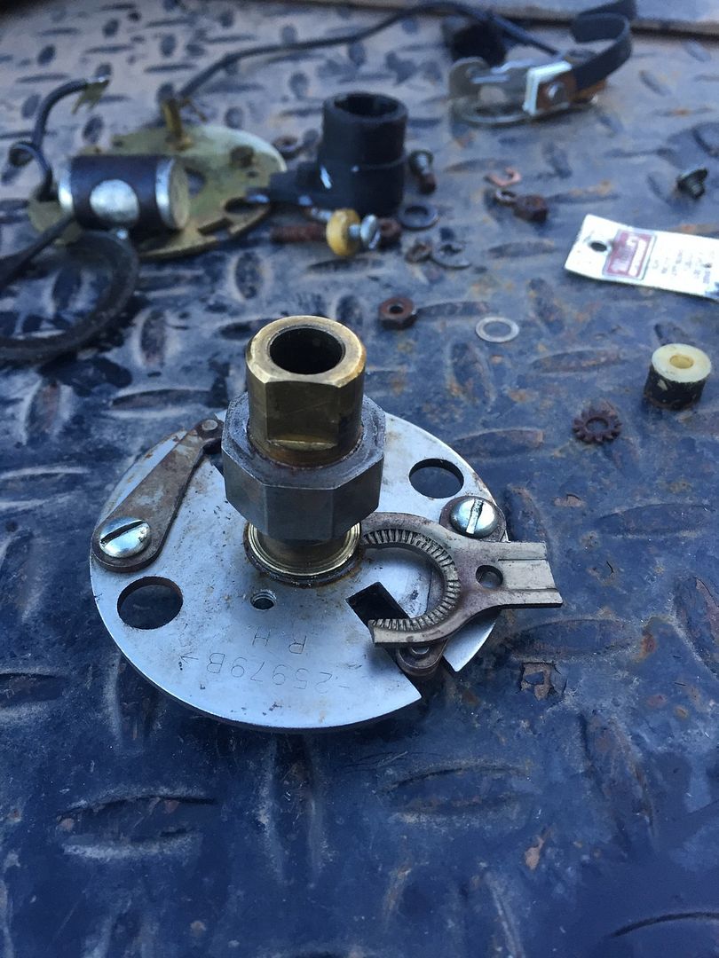

About got stranded the other day on the lake. I was sailing along about 45 headed over to the smooth water at the dam to do some knee boarding and drink some beers when my motor skipped a few beats. I slowed down and it died. I pulled the cap off and noticed I could spin the rotor by hand with almost no resistance when I was checking the advance. Tried about 4 times and got it close to in time and headed towards the ramp running it what sounded like very retarded. Anyways I poped it out when I got home and it's spinning inside. Took it apart and it seems all that holds it from spinning is a little clamp held down by one bolt? Any suggestions for making it stay put?

What are you working on? Are you talking about the distributor hold down clamp?
Ayuh,..... The distributor Housin' is loose,..??
Ya, just that clamp, 'n that short bolt is All that's necessary,....
Was the clamp upside- down,..??
or was the bolt loose,..??
53,262
is the drive tang intact under the rotor?

I traced the spinning to here. Seems this little tab is all that holds it from spinning?
