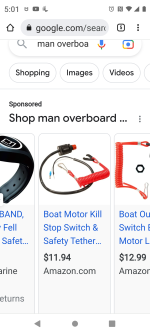

I put one of these on a Johnson 25 recently and it worked fine. No idea how long it will last.

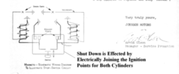

killing involves joining the points via a normall open push switch... very simple but has explained the wires must exit the bottom of the mag plate to reach the switch mounted somewhere ... if no holes are available just drill one and protect thewires from chaffing with heat shrink tubing or rubber grommet
any similar automotive normal open "start" switch would work
or these....
