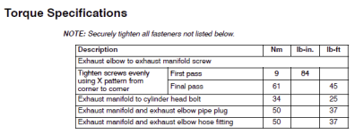

Hello boaters,
During the winter I have inspected and repainted my manifolds + elbows. It looks fine,
my question is, after torquening the bolts should i re-torque them after 1st boating?
I cannot find this info and also I cannot find torque values for manifold and elbows..
I have also new gasket with restricted flow
Should the restricted hole be mounted as in the mercruiser diagrams towards the rear of the boat?
And questions regarding bolts, new bolts have red loctide i guess, should I put red one again or i can replace it with perfect seal?
All the best friends!

Iirc the torque spec for manifold/riser is 25-35 lb/ft. Only reason I remember is to me it seems low but it is the spec. Can't recall ever using a torque wrench on those bolts, my method is tighten, run it and move on the next project, ymmv

I replaced my manifolds and elbows recently on a 4.3L, my manual called for 33ft lbs and to retorque after a heat cycle.

Hello boaters,
No.
I would use a low strength loctite, like 222.
That's for the old 'non dry-joint' manifolds and elbows.
Chris....

Thanks AChris for screenshot but i understand this seawater inlet should I put it as on the diagram ? But here it says this 1656429439010.jpeg

When You go to parts catalog, here is the picture:1656501637334.png
and there, you see the gasket with restrictor hole towards the back of the boat,
but on this picture: it says: Restrictor hole always opposite of the exhaust riser
1656429439010-jpeg.364234

Ignore the position on the 'parts catalogue', that's all it is, a parts catalogue, not an assembly drawing. The manual I posted from is the genuine Merc service manual #37 (Dry-joint exhaust systems), page 7B-7....
I think I'd trust the (genuine) service manual before a parts catalogue...
Chris......

I will Thank you for your help. I have manual only for V6 engines
@achris can You please post a pages from this manual
Franco_boater
Nov 2, 2021
130
Ok good night here its early evening, Ive found #37 is for V8 only but Ive got V6 with Dry joints, wondering why

I think 242 is the blue and 262 is red. Both are stronger than you need.
