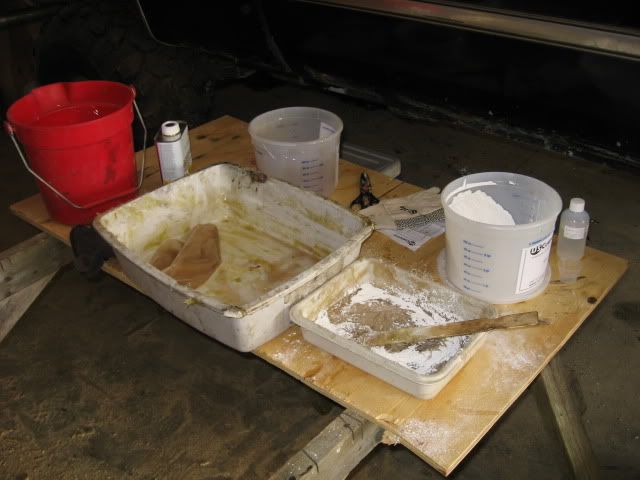

Well I retrieved the camera from the shop, so here are some pics for your enjoyment purposes!
Here is my mixing table
Here are the corners of the transom that I filled with the talc, resin, 1/4 inch chopped fiber, and 1.5 OZ CSM
Here is the connection between the bottom of the transom and the bottom of the hull. Rather than filling the gap between the core and hull, I filled it with the same mix I used in the transom corners.
And best of all, here is the near-completed transom! I still have a layer of 1.5 CSM to put on followed by 18 oz roving. Once cured i will add another layer of 1.5 CSM!
Let me know what you guys think!

Hey boatflipper,
Looking good.
I used pretty much the mixture you did to fill around the transom. I just used wood flour instead of talc.
On the transom I used two layers of 18 oz roving and two of 1.5oz CSM.
Looks Good.
Bob
