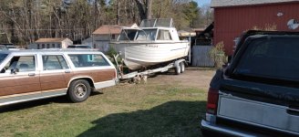

Thread is dead, I know, but I am back. Sold the Jeep and got a V8 woody wagon tow vehicle to be ready to pickup a Chieftain 25 when I found it. A few months later, I found it and the 25 is in the yard! Only been working on it the past month or so. I will be starting a new thread for the restore shortly. Hoping there are still some knowledgeable Starcraft fans out there that'll be interested in giving me a few pointers along the way.

Sure is a rare find to get a 25'r, lets see some photos of the big tin!
It really is and was very lucky to find. Here she is! Just started a new thread today that will have loads of pictures as time goes on. 1974 Chieftain 25 Adventurer Restoration

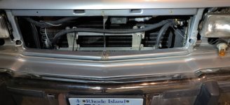

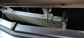

Do you have a big trans cooler on the woody? Did you have to add airbags?

Yes, I added a big ass trans cooler from a F350 Super Duty pickup in addition to a new rad. Added Monroe air shocks and a small compressor with dash gauge and control. Towed the boat great despite trailer not having brakes. 😎
