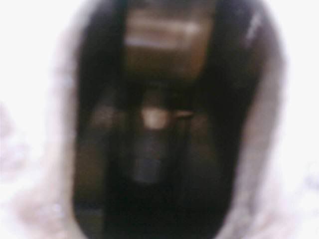

heres the deal, I guess the pic says it all.
That bright shiny non lobe area is where it once pushed the mechanical fuel pump arm..
