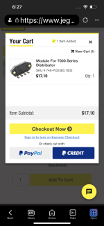

I have ATK marine 351w in my 67F100 with same ignition system. Started out good then went bonkers twice. Go to Summit Racing sight and do some digging. You will find a correct ohm (much better) coil and with a little more digging a replacement “module” (very small price) and I bet it will work fine. Also if you ever mess with the gutts of that dizzy you gotta be absolutely sure you have every thing in perfect position or it will eat it’s self. Now thats just from my experience only. Mine has worked great since and tows the SeaRay 220 just fine now.
Masinc
Oct 8, 2021
35
Maybe not even the problem but I keep an extra one of these and some zinc thermal paste in the glovebox just in case.
