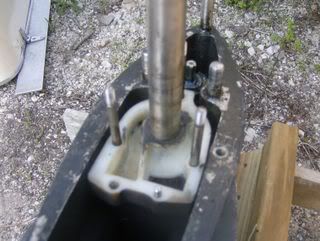

Here is a picture showing the condition of the lower water pump housing and gasket when i opened it up. Is there something on the shift part that i may have missed resealing that I should look for when i replace the lower pump housing?
Don S
Aug 31, 2004
62,321
Re: merc 165 lower unit leak
No way of telling where the problem is from that picture.
If it were me, I would plug the oil passage hole, put the upper housing on the water pump and pressure check the lower. Also look at the seal in the upper where the input shft goes.
