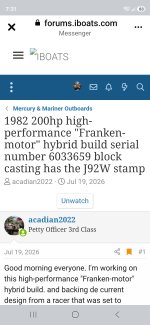

Hi Chris. the engine apparently was a custom built let me see if I can copy paste my previous post from this forum to avoid any error as to the help I received to id thos engine

it under this title Dukedog is the one who help me lots finding out about this engine specifications. in a perfect world I would have a dial indicator 10 to 1 from Mike ( Bucksh..77 company in Florida however I sent a few messages and yet received a reply
