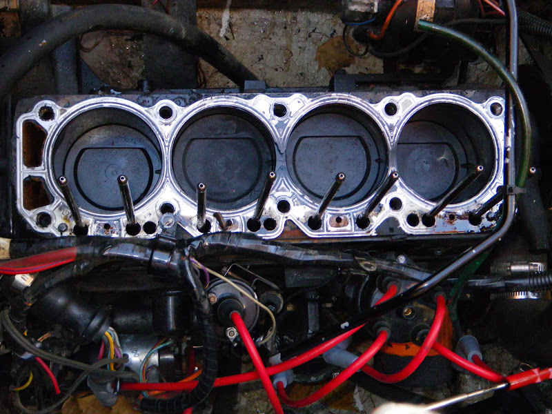

OK, the good: Exhaust manifold wasn't leaking.
The Bad: Definite head gasket failure with head and block damage. Do you think the big chunk of impeller stuck in the water passage contributed? </sarcasm>.
Here is the overall pic and you can see the blown out gasket.
Close up of the block, very similar damage to the head (a small crack down the center between the cylinders)
Here's a question, what is with the exhaust valve on the left "retracted into the head? Burnt I am guessing?
Opinions on fixing it? I know some will say the engine is done for but curious if there are any reasonable fixes to be had. Replacing the engine is not gonna happen for cost reasons (would look for another boat instead most likely).

Re: Merc 3.0 Low Compression 2 & 3
Ayuh,... No Buts to be found,.... Picture #2 tells the story.... That's a Dead Horse....
The sunken valve is seat failure, valve failure, or both...
You've pretty much got an Anchor,...
I'll give you your nickel the next time I see you, t. But you obviously left out overheat issues. Cause that is what the impeller blade was doing in there. The valve could be tulipped, due to the high heat in the combustion chamber.
Thanks for all the advice. Kind of curious here, with the sunken valve, seat of the pants feel says the valve spring on that valve is weaker than on the other valves. Could that have contributed to the valve failure since the valve might have a tendency to float at higher rpms? Just not sure how likely that is. It's not like barely staying close kind of weak but certainly not as strong.
coheej
Sep 15, 2010
128
The valve spring is definitely weaker now, but is not the cause of the seat failure. The spring should have been at normal strength when the failure started to happen.
I think he indicated the block was cracked also. The crank and rods may be good, but other than accessories everthing else is mostly junk.
And yeah, the impeller bit me. A case of 'it ran fine on muffs' but overheated first time out. I didn't run it long myself (shut it down and paddled back to shore for an hour) but considering how bad the impeller was I wouldn't be surprised if the previous owner had overheated it before he sold it to the next sucker (me!).
After cleaning it up the two cracks are very small and neither looks like it extends past the surface. The head leveled out pretty well within spec (<0.004) but not sure about the block yet. From what I can see it doesn't extend into the cylinder walls. If the block will clean up OK, I will slap a gasket on and see how long I can get out of it. Considering that it's a case of tossing the motor if it blows, not really sure what I have to lose. The sunken valve is definitely a concern but again, worst case I blow the motor. The motor was actually still running well last time I was out, 38-39 mph 4300RPM 19P prop with 3 people on board so hoping I can get a little more time out of it.
Taking bets for how long until my inevitable post of 'Anyone know where to get a good used 3.0 motor?' :)
Question for the guys who actually know what they are doing, why are the water passages into the head restricted at the head gasket? If you look the passage is much bigger than the hole in the gasket which is where the impeller chunk lodged. You can see it laying next to the passage in the first picture.
If you're .004" low in the middle between those two cylinders, you're wasting your time.
The holes in the gasket controls the water flow in each area of the block and head for uniform cooling. If it didn't restrict the flow you would have hot & cold spots.
