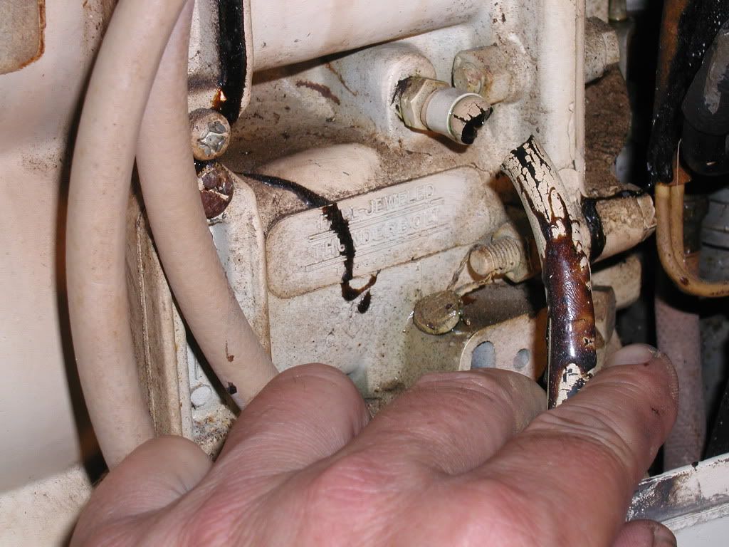

Ok here is a picture of what I am talking about. What is this line for and is it something that needs to be replaced right now or is it a run off of unspent fuel or something that can wait for a bit? Also...see the fuel lines(what little you can)..how do they look? And....see the brown runny goo that seems to be all over the power head and laying in the bottom of the pan and even some on the cowl insulation....I was worried that it was a melting stator but someone told me that it was probably extra sealant or something like they used for the head gasket and not to worry....thoughts?

I'd be willing to bet the gooey brown stuff smells like varnish. Hmmmm maybe cause it is. As far as the $40 dollar hose assy... buy a chunk of 1/4" (oil impervious) hose from NAPA and stick it on there with a new clamp. Bleeder hoses are not absolutely necessary but leaky ones will contribute to poor running. These old models are tough old birds.... they go and go and go and go.............. like an ever ready bunny. ;)

That's a oil recirculating hose. Replace it, you need it working.
Any fuel hose of the same dia will work.

Tim......lol yep pretty pricey item. I'd go with fuel rated hose, as suggested, and yes it should be replaced before you run the motor again. I am not sure what the line is, but I don't think the old inlines have "oil return lines", looks more like its for fuel return from the lower crankcase.

ya replace that line is an oil line. it weird for me cause i just gave the line a bump and it broke off.
acually the brown stuff on the block i think is the from the stator probably melted like mine but dont touch it the stator it might still be good unless u dont have the charging system?
