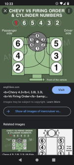

2nd - is it connected correctly, the motor turns fine and works but according to the timings and what cylinder should be connected to what point-needle on the dist cap they would ve incorrect. Im not sure if i should move the wire plugs to how they are supposed to be. The diagram below is how it is connected as of now and the bottom part is the front of the boat and the distributor cap is how it looks from above on the motor installed exactly.

Hey Scott could you elaborate? This sketch that I drew is how the motor/distributor/cables would look if you were looking towards the stern with the port side on your right side while looking back. From what I have seen from other images explaining the numbers --- is number 1 cylinder would be on the "lower right" of the image and 2 on the lower left.

I have attached an image of how i think it is supposed to be connected, is this right? Also I have attached a pic of what my distributor cap looks like, i see it has two numbers is this if it turns left or right??
Ok. Quite plain to see what’s going on after you posted these pics.
So most normal LH rotation engines are 1-6-5-4-3-2 order.
Looks like your cap if it’s pictures as being the same as the one on the right showing that cap, is telling me that is a RH reverse rotation part. They are 1-2-3-4-5-6 I’m sure. Is it a LH conventional engine you have ?

Yes it says on the filter its a LH rotational engine. So i wow id be using the clockwise numbers by the towers right?
If it’s left hand…you’d be using a conventional set up and be 1-6-5-4-3-2 firing order and suited cap. If it was a RH cap..I don’t imagine it would run hardly at all.

Would you suggest following this diagram to where the wires should be connected? Or is there another diagram with a different way to connect it?

You can reverse 2 plug wires and it wont even get on plane, just follow the diagram in post 7

I really am dumbfounded and will be able to try it this thursday, but right know it is connected like this the first number being the tower # the second the cylinder number going clockwise or LH. As per post #1 diagram
1 to #3 cyl
6 to #2 cyl
5 to #1 cyl
4 to #6 cyl
3 to #5 cyl
2 to #4 cyl.
Like i said it cranks fine 33 mphs.... i cant seem to find the reason or why it would be connected like this.
I will be changing the coil cable as i think it is also open
50,591
Never assume the tower on the dizzy is in a specific location. The tower the rotor is pointing to when the motor is at TDC is number 1
