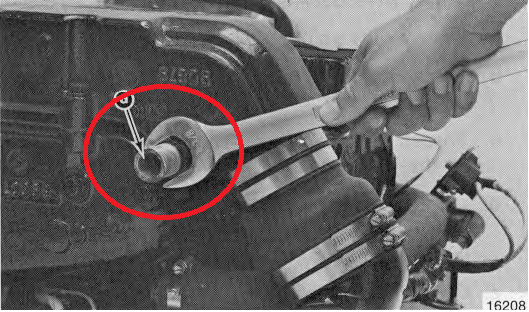

The hot water leaves the exchanger into a hose that goes from the exchanger and enters the very end of the riser and gets dumped directly into the exhaust it does not flow through the entire riser as it does in a conventional system the coolant does, so if the issue was there he would only need to remove and replace the inlet the hose connects to not the hole riser.
If the issue was on the coolant side of the system yes I would agree that the riser is a possible location for the problem, but its not and it is more likely that the issue is a bad/plugged up exchanger or clogged hose, but if he doesn't go through the entire system as I have explained twice he wont find out and jumping pass all the hoses and the exchanger to the riser is just dumb, it only requires pulling some hoses off and seeing if water is getting through.
When troubleshooting you dont just check the beginning of a system then assume the issue is all the way at the end cutting out all the crap in the middle of the system. You follow the system till you find the for sure what the issue is.
The inlet to riser
The coolant system
White arrows- sea water
Black arrows- coolant
