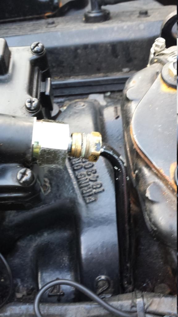

It's dripping gas between the line nut on the carb and the nut on the line from the fuel pump. Right now, there is no gasket at that junction. Does anyone know if there should be?

Why does working on this boat turn me into such a dumbass? A little pipe sealer goes a long way...
It's hard to tell from the picture, but I believe you should have a flare fitting, and no sealer should be necessary. The flare may have a nick or imperfection... but you should be able to simply tighten the flare nut. Sealer would be a band aid at best and is only used with pipe thread.

The exploded view clearly shows a gasket, you goinna trust your life to a little dab of pipe sealant?

IIRC, there should be a copper washer there. Don't know how pipe dope and gas get along, but probably wouldn't try to find out.
